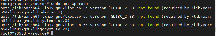

22.04源设定成24.04更新之后报错!!!!!!
报错如下,请大神解决

安装libopencv-dev,报了下问题,后续就崩了:
Installing new version of config file /etc/systemd/journald.conf ...
Installing new version of config file /etc/systemd/logind.conf ...
Installing new version of config file /etc/systemd/networkd.conf ...
Installing new version of config file /etc/systemd/pstore.conf ...
Installing new version of config file /etc/systemd/sleep.conf ...
Configuration file '/etc/systemd/system.conf'
==> Modified (by you or by a script) since installation.
==> Package distributor has shipped an updated version.
   What would you like to do about it ?  Your options are:
    Y or I  : install the package maintainer's version
    N or O  : keep your currently-installed version
      D     : show the differences between the versions
      Z     : start a shell to examine the situation
The default action is to keep your current version.
*** system.conf (Y/I/N/O/D/Z) [default=N] ? y
Installing new version of config file /etc/systemd/system.conf ...
Installing new version of config file /etc/systemd/user.conf ...
systemd-machine-id-setup: /lib/aarch64-linux-gnu/libm.so.6: version `GLIBC_2.39' not found (           required by /usr/lib/aarch64-linux-gnu/systemd/libsystemd-shared-255.so)
systemd-machine-id-setup: /lib/aarch64-linux-gnu/libc.so.6: version `GLIBC_2.36' not found (           required by /usr/lib/aarch64-linux-gnu/systemd/libsystemd-shared-255.so)
systemd-machine-id-setup: /lib/aarch64-linux-gnu/libc.so.6: version `GLIBC_2.38' not found (           required by /usr/lib/aarch64-linux-gnu/systemd/libsystemd-shared-255.so)
systemd-machine-id-setup: /lib/aarch64-linux-gnu/libc.so.6: version `GLIBC_2.38' not found (           required by /lib/aarch64-linux-gnu/libgcrypt.so.20)
systemd-machine-id-setup: /lib/aarch64-linux-gnu/libc.so.6: version `GLIBC_2.38' not found (           required by /lib/aarch64-linux-gnu/libcrypto.so.3)

 楼主| 发表于 2026-1-28 18:12:12 | 显示全部楼层
何浩钧 发表于 2026-1-28 18:04
重新用回22.04也不行吗
不行,源改回22.04的源,执行sudo apt update 还有其他有关apt都报错了,就是第一个图的错
发表于 2026-1-28 18:13:09 | 显示全部楼层
daiwenbin81 发表于 2026-1-28 18:12
不行,源改回22.04的源,执行sudo apt update 还有其他有关apt都报错了,就是第一个图的错 ...
那就clean一下,按照报错提示,把依赖关系修复一下

 楼主| 发表于 2026-1-28 18:22:19 | 显示全部楼层
具体怎么操作
