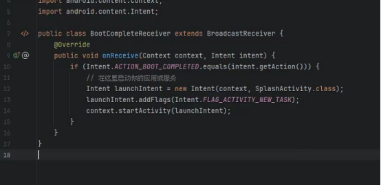

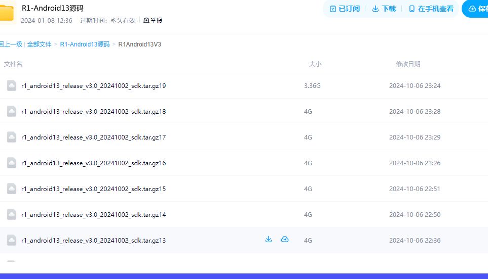

youyeetoo R1 3588s android 13 设置app开机自启动失败,在android 9 上可以实现开机自启动,在android 13 运行下失败,代码如下
报错信息如下:
I  START u0 {=0x10000000 cmp=com.orbbec.ranging/.activity.SplashActivity} from uid 10098
2024-10-07 20:21:51.594   589-1015  ActivityTaskManager     system_server                        W  Background activity start [callingPackage: com.orbbec.ranging; callingUid: 10098; appSwitchState: 2; isCallingUidForeground: false; callingUidHasAnyVisibleWindow: false; callingUidProcState: RECEIVER; isCallingUidPersistentSystemProcess: false; realCallingUid: 10098; isRealCallingUidForeground: false; realCallingUidHasAnyVisibleWindow: false; realCallingUidProcState: RECEIVER; isRealCallingUidPersistentSystemProcess: false; originatingPendingIntent: null; allowBackgroundActivityStart: false; intent: Intent { =0x10000000 cmp=com.orbbec.ranging/.activity.SplashActivity }; callerApp: ProcessRecord{c07be98 1609:com.orbbec.ranging/u0a98}; inVisibleTask: false]2024-10-07 20:21:51.595   589-1015  Compatibil...geReporter system_server
请问在 android 13 下如何设置实现app开机自启动?
