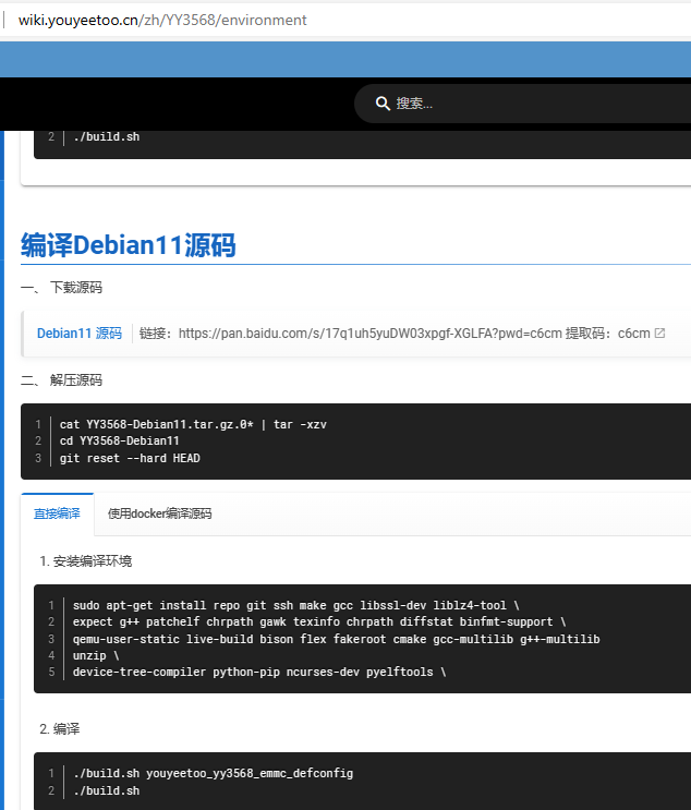

硬件主板型号:YY3568
按照以上步骤,出现如下错误:
rlk@rlk:~/yy3568/Ubuntu/sdk$ ./build.sh youyeetoo_yy3568_emmc_defconfig
Log saved at /home/rlk/yy3568/Ubuntu/sdk/output/log/2024-01-04_10-09-20
No such defconfig: youyeetoo_yy3568_emmc_defconfig
ERROR: Running ./build.sh - run_hooks init youyeetoo_yy3568_emmc_defconfig failed!
ERROR: exit code 1 from line 160:
    /home/rlk/yy3568/Ubuntu/sdk/device/rockchip/common/build-hooks/00-config.sh init youyeetoo_yy3568_emmc_defconfig
ERROR: call stack:
    build.sh: run_hooks(160)
    build.sh: run_build_hooks(171)
    build.sh: main(359)
    build.sh: main(489)
