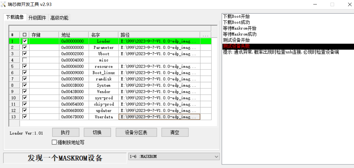

发表于 2023-11-24 16:29:32 | 显示全部楼层 |阅读模式
硬件主板型号:
固件名称/系统版本:
自编的或固件下载地址: image.png
16:46:06 758        Layer<1-6>:下载Boot开始
16:46:06 759        Layer<1-6>:下载Boot成功
16:46:06 760        Layer<1-6>:等待Maskrom开始
16:46:07 181        Layer<1-6>:等待Maskrom成功
16:46:07 182        Layer<1-6>:测试设备开始
16:46:07 183        Error:RKU_Write-->WriteFile failed,bRet=0,err=1,size=31,write=0
16:46:09 184        ERROR:RKU_ResetPipe-->DeviceIoControl failed,err=1
16:46:09 184        <LAYER 1-6> ERROR:TestDevice-->RKU_TestDeviceReady failed,RetCode(-3),path=\\?\USB#VID_2207&ID_5000#150100414A54443452033A5BF4BA7A00#{a5dcbf10-6530-11d2-901f-00c04fb951ed}
16:46:10 186        Error:RKU_Write-->WriteFile failed,bRet=0,err=1,size=31,write=0
16:46:12 186        ERROR:RKU_ResetPipe-->DeviceIoControl failed,err=1
16:46:12 186        <LAYER 1-6> ERROR:TestDevice-->RKU_TestDeviceReady failed,RetCode(-3),path=\\?\USB#VID_2207&ID_5000#150100414A54443452033A5BF4BA7A00#{a5dcbf10-6530-11d2-901f-00c04fb951ed}
16:46:13 187        Error:RKU_Write-->WriteFile failed,bRet=0,err=1,size=31,write=0
16:46:15 188        ERROR:RKU_ResetPipe-->DeviceIoControl failed,err=1
16:46:15 188        <LAYER 1-6> ERROR:TestDevice-->RKU_TestDeviceReady failed,RetCode(-3),path=\\?\USB#VID_2207&ID_5000#150100414A54443452033A5BF4BA7A00#{a5dcbf10-6530-11d2-901f-00c04fb951ed}
16:46:16 191        Errorayer<1-6>:测试设备失败
16:46:16 198        Layer<1-6>: RunProc is ending, ret=0
17:14:50 388        Layer<1-6>:下载Boot开始
17:14:50 390        Layer<1-6>:下载Boot成功
17:14:50 391        Layer<1-6>:等待Maskrom开始
17:14:50 814        Layer<1-6>:等待Maskrom成功
17:14:50 815        Layer<1-6>:测试设备开始
17:14:50 815        Error:RKU_Write-->WriteFile failed,bRet=0,err=1,size=31,write=0
17:14:52 817        ERROR:RKU_ResetPipe-->DeviceIoControl failed,err=1
17:14:52 817        <LAYER 1-6> ERROR:TestDevice-->RKU_TestDeviceReady failed,RetCode(-3),path=\\?\USB#VID_2207&ID_5000#150100414A54443452033A5BF4BA7A00#{a5dcbf10-6530-11d2-901f-00c04fb951ed}
17:14:53 818        Error:RKU_Write-->WriteFile failed,bRet=0,err=1,size=31,write=0
17:14:55 819        ERROR:RKU_ResetPipe-->DeviceIoControl failed,err=1
17:14:55 819        <LAYER 1-6> ERROR:TestDevice-->RKU_TestDeviceReady failed,RetCode(-3),path=\\?\USB#VID_2207&ID_5000#150100414A54443452033A5BF4BA7A00#{a5dcbf10-6530-11d2-901f-00c04fb951ed}
17:14:56 820        Error:RKU_Write-->WriteFile failed,bRet=0,err=1,size=31,write=0
17:14:58 821        ERROR:RKU_ResetPipe-->DeviceIoControl failed,err=1
17:14:58 821        <LAYER 1-6> ERROR:TestDevice-->RKU_TestDeviceReady failed,RetCode(-3),path=\\?\USB#VID_2207&ID_5000#150100414A54443452033A5BF4BA7A00#{a5dcbf10-6530-11d2-901f-00c04fb951ed}
17:14:59 823        Errorayer<1-6>:测试设备失败
17:14:59 833        Layer<1-6>: RunProc is ending, ret=0
17:18:13 310        Error:RKU_Write-->WriteFile failed,bRet=0,err=1,size=31,write=0
17:18:15 312        ERROR:RKU_ResetPipe-->DeviceIoControl failed,err=1
17:18:15 312        Error:ResetMaskromProc-->RKU_ResetDevice failed,err=-3
17:18:23 751        Error:RKU_Write-->WriteFile failed,bRet=0,err=1,size=31,write=0
17:18:25 751        ERROR:RKU_ResetPipe-->DeviceIoControl failed,err=1
17:18:25 751        Error:ResetMaskromProc-->RKU_ResetDevice failed,err=-3
17:18:30 420        Layer<1-6>:下载Boot开始
17:18:30 421        Layer<1-6>:下载Boot成功
17:18:30 422        Layer<1-6>:等待Maskrom开始
17:18:30 844        Layer<1-6>:等待Maskrom成功
17:18:30 846        Layer<1-6>:测试设备开始
17:18:30 846        Error:RKU_Write-->WriteFile failed,bRet=0,err=1,size=31,write=0
17:18:32 847        ERROR:RKU_ResetPipe-->DeviceIoControl failed,err=1
17:18:32 847        <LAYER 1-6> ERROR:TestDevice-->RKU_TestDeviceReady failed,RetCode(-3),path=\\?\USB#VID_2207&ID_5000#150100414A54443452033A5BF4BA7A00#{a5dcbf10-6530-11d2-901f-00c04fb951ed}
17:18:33 848        Error:RKU_Write-->WriteFile failed,bRet=0,err=1,size=31,write=0
17:18:35 849        ERROR:RKU_ResetPipe-->DeviceIoControl failed,err=1
17:18:35 849        <LAYER 1-6> ERROR:TestDevice-->RKU_TestDeviceReady failed,RetCode(-3),path=\\?\USB#VID_2207&ID_5000#150100414A54443452033A5BF4BA7A00#{a5dcbf10-6530-11d2-901f-00c04fb951ed}
17:18:36 850        Error:RKU_Write-->WriteFile failed,bRet=0,err=1,size=31,write=0
17:18:38 851        ERROR:RKU_ResetPipe-->DeviceIoControl failed,err=1
17:18:38 851        <LAYER 1-6> ERROR:TestDevice-->RKU_TestDeviceReady failed,RetCode(-3),path=\\?\USB#VID_2207&ID_5000#150100414A54443452033A5BF4BA7A00#{a5dcbf10-6530-11d2-901f-00c04fb951ed}
17:18:39 853        Errorayer<1-6>:测试设备失败
17:18:39 863        Layer<1-6>: RunProc is ending, ret=0

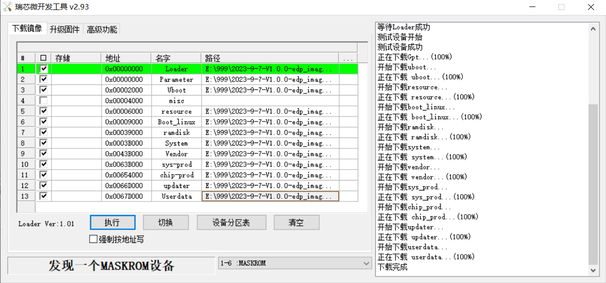

在Loader状态下镜像已经下载完成,系统自动进入到Maskrom和模式,在Maskrom和模式下无论进行什么动作都是失败的,这个是什么情况!!!

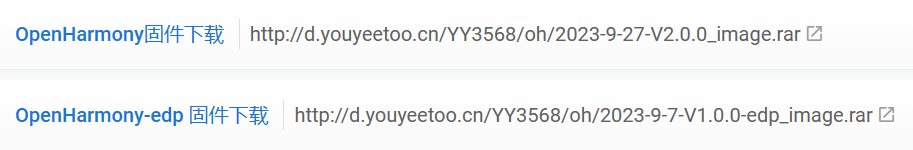

发表于 2023-11-24 16:37:01 | 显示全部楼层
系统能起来吗,鸿蒙系统默认识别为maskrom模式,不是adb模式
207
207
 楼主| 发表于 2023-11-24 16:57:33 | 显示全部楼层
已从adb模式切换到maskrom模式,系统还是起不来

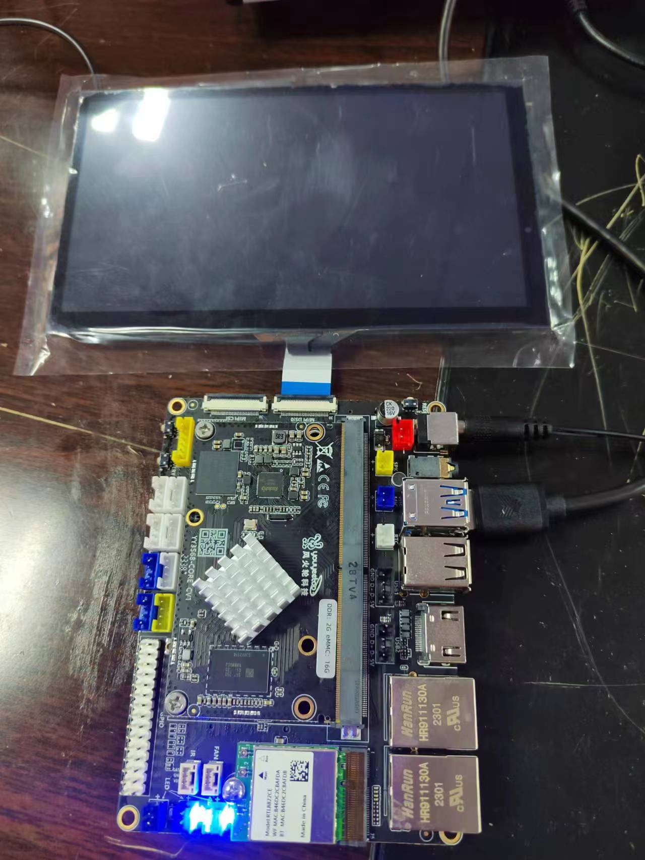

发表于 2023-11-24 18:24:12 | 显示全部楼层
源码默认不带7寸屏驱动,需要你改一下设备树,你接HDMI看一下
230
230
发表于 2023-12-7 16:08:45 | 显示全部楼层
请问怎么修改设备树呢,是需要下载源码才能修改吗
发表于 2023-12-8 09:06:52 | 显示全部楼层
http://wiki.youyeetoo.cn/zh/YY3568/screen
230
230
发表于 2023-12-14 15:00:46 | 显示全部楼层
我的意思是这个设备树是在open Harmony源码的哪个位置呢?我用的版本4,但是没有找到.dtsi后缀的文件呢,添加的话也不知道添加到哪个位置
发表于 2023-12-15 09:54:26 | 显示全部楼层
erye 发表于 2023-12-14 15:00
我的意思是这个设备树是在open Harmony源码的哪个位置呢?我用的版本4,但是没有找到.dtsi后缀的文件呢, ...
版本4没了解过,我们提供的是3.2
