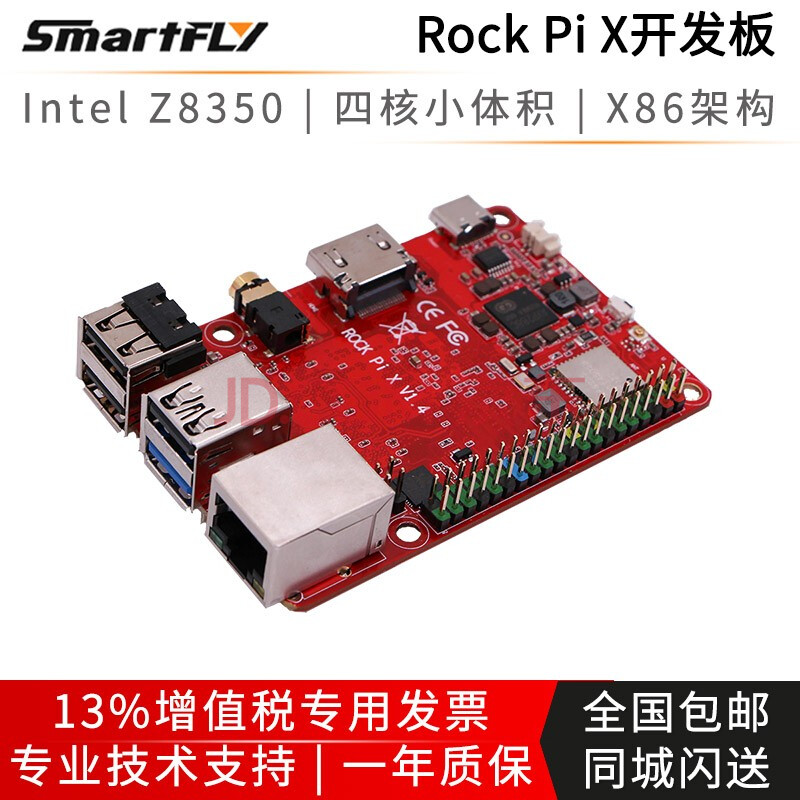

rock pi X 样机购买
https://item.jd.com/10023999606367.html
