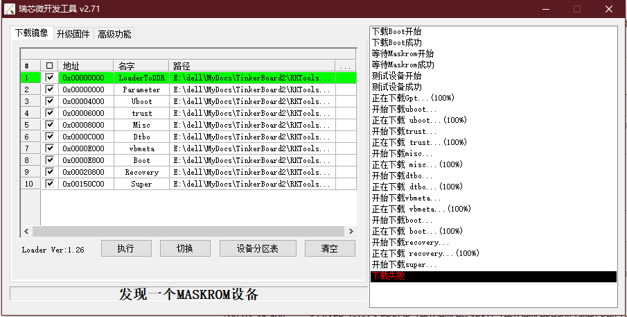

使用AndroidTool_Release_v2.71工具烧录super.img一直失败,怎么解决
镜像是自己用github源码编译的。
日志显示Error:RKU_Read-->ReadFile failed:
00:02:40 798        Layer<1-1-2>:下载Boot开始
00:02:46 261        <LAYER 1-1-2> ERROR:Boot_VendorRequest-->DeviceIoControl failed,Total(116738),Sended(0),bRet(1),err(0)
00:02:46 297        <LAYER 1-1-2> ERRORownloadBoot-->Boot_VendorRequest471 failed,index(0)
00:02:46 365        Errorayer<1-1-2>:下载Boot失败
00:03:07 762        Error:RKU_Write-->WriteFile failed,bRet=0,err=31,size=31,write=0
00:03:19 794        ERROR:RKU_ResetPipe-->DeviceIoControl failed,err=995
00:03:19 795        <LAYER 1-1-2> ERROR:TestDevice-->RKU_TestDeviceReady failed,RetCode(-3),path=\\?\USB#VID_2207&ID_330C#6&2E2F5DEF&0&2#{a5dcbf10-6530-11d2-901f-00c04fb951ed}
00:03:25 831        Error:RKU_Write-->WriteFile failed,bRet=0,err=995,size=31,write=0
00:03:38 803        ERROR:RKU_ResetPipe-->DeviceIoControl failed,err=995
00:03:38 804        <LAYER 1-1-2> ERROR:TestDevice-->RKU_TestDeviceReady failed,RetCode(-3),path=\\?\USB#VID_2207&ID_330C#6&2E2F5DEF&0&2#{a5dcbf10-6530-11d2-901f-00c04fb951ed}
00:03:44 830        Error:RKU_Write-->WriteFile failed,bRet=0,err=995,size=31,write=0
00:03:46 833        ERROR:RKU_ResetPipe-->DeviceIoControl failed,err=31
00:03:46 835        <LAYER 1-1-2> ERROR:TestDevice-->RKU_TestDeviceReady failed,RetCode(-3),path=\\?\USB#VID_2207&ID_330C#6&2E2F5DEF&0&2#{a5dcbf10-6530-11d2-901f-00c04fb951ed}
00:30:44 931        Layer<1-1-2>:测试设备开始
00:30:45 350        Layer<1-1-2>:测试设备成功
00:30:45 584        Layer<1-1-2>: Download gpt...
00:30:45 668        Layer<1-1-2>: Download uboot at 0x00004000...
00:30:45 927        Layer<1-1-2>: Download trust at 0x00006000...
00:30:46 124        Layer<1-1-2>: Download misc at 0x00008000...
00:30:46 166        Layer<1-1-2>: Download dtbo at 0x0000c000...
00:30:46 210        Layer<1-1-2>: Download vbmeta at 0x0000e000...
00:30:46 264        Layer<1-1-2>: Download boot at 0x0000e800...
00:30:47 768        Layer<1-1-2>: Download recovery at 0x00020800...
00:30:50 280        Layer<1-1-2>: DownloadSparse super at 0x00150c00...
00:30:50 282        INFOownloadSparseImage-->erase start,file=E:\dell\MyDocs\TinkerBoard2\RKTools\windows\AndroidTool\AndroidTool_Release_v2.71\images\super.img,unsparse=6373376,partition=6373376
00:30:50 310        Error:RKU_Read-->ReadFile failed,bRet=0,err=31,size=13,read=0
00:31:02 820        ERROR:RKU_ResetPipe-->DeviceIoControl failed,err=995
00:31:02 821        ERROR:ErasePartition-->erase partition failed,err=-4
00:31:02 840        ERRORownloadSparseImage-->erase partition failed,partition=super
00:31:02 873        Layer<1-1-2>: RunProc is ending, ret=0

搞定了,VMware虚拟机导致设备识别出错,关掉虚拟机就可以正常烧录了。
