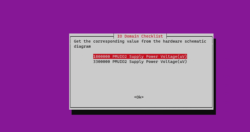

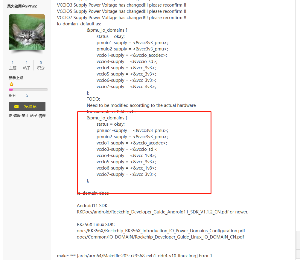

YY3568 编译Debian系统源码,编译到一半会出现选择电压的提示界面如下:
然后报错:
============Start building kernel============
TARGET_ARCH          =arm64
TARGET_KERNEL_CONFIG =rockchip_linux_defconfig
TARGET_KERNEL_DTS    =rk3568-evb1-ddr4-v10-linux
TARGET_KERNEL_CONFIG_FRAGMENT =
# configuration written to .config
scripts/kconfig/conf  --syncconfig Kconfig
  CALL    scripts/checksyscalls.sh
  CHK     include/generated/compile.h
  GZIP    kernel/config_data.gz
  Image:  kernel.img is ready
  Building modules, stage 2.
  MODPOST 3 modules
found ./arch/arm64/boot/dts/rockchip/.rk3568-evb1-ddr4-v10-linux.dtb.dts.tmp
PMUIO2 Supply Power Voltage has changed!!! please reconfirm!!!
VCCIO1 Supply Power Voltage has changed!!! please reconfirm!!!
VCCIO3 Supply Power Voltage has changed!!! please reconfirm!!!
VCCIO5 Supply Power Voltage has changed!!! please reconfirm!!!
VCCIO7 Supply Power Voltage has changed!!! please reconfirm!!!
io-domian  default as:
                        &pmu_io_domains {
                                status = okay;
                                pmuio1-supply = <&vcc3v3_pmu>;
                                pmuio2-supply = <&vcc3v3_pmu>;
                                vccio1-supply = <&vccio_acodec>;
                                vccio3-supply = <&vccio_sd>;
                                vccio4-supply = <&vcc_3v3>;
                                vccio5-supply = <&vcc_3v3>;
                                vccio6-supply = <&vcc_3v3>;
                                vccio7-supply = <&vcc_3v3>;
                        TODO:
                        Need to be modified according to the actual hardware
                        for example rk3568-evb:
                        &pmu_io_domains {
                                status = okay;
                                vccio4-supply = <&vcc_1v8>;
                                vccio6-supply = <&vcc_1v8>;
                io-domain docs:
                Android11 SDK:
                RKDocs/android/Rockchip_Developer_Guide_Android11_SDK_V1.1.2_CN.pdf or newer.
                RK356X Linux SDK:
                docs/RK356X/Rockchip_RK356X_Introduction_IO_Power_Domains_Configuration.pdf
                docs/Common/IO-DOMAIN/Rockchip_Developer_Guide_Linux_IO_DOMAIN_CN.pdf
make: *** [arch/arm64/Makefile:203: rk3568-evb1-ddr4-v10-linux.img] Error 1
ERROR: Running build_kernel failed!
ERROR: exit code 2 from line 677:
    make ARCH=$RK_ARCH $RK_KERNEL_DTS.img -j$RK_JOBS
发表于 2023-8-29 18:24:34 | 显示全部楼层
微信截图_20230829182307.png ,按这个选

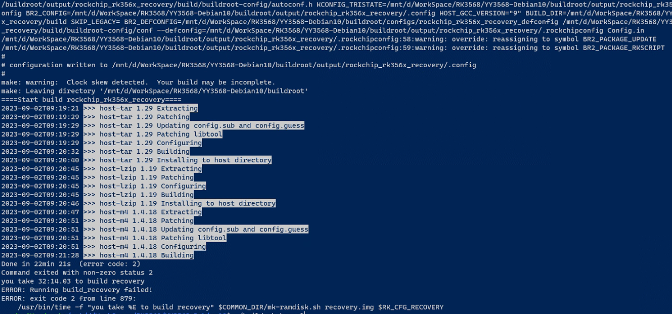

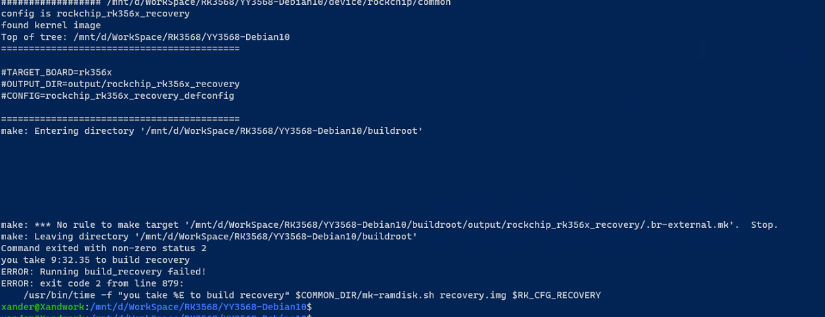

有新的问题:
发表于 2023-9-5 13:54:24 | 显示全部楼层
把buildroot/output/rockchip_rk356x_recovery删除,重新编译试一下

 楼主| 发表于 2023-9-6 13:28:30 | 显示全部楼层
试过了不行
